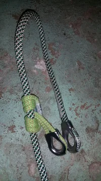

Aluminum Ring canopy anchor
Yes I use a quickie for straight up and down quick work. But for major moving around on big reductions and prunes this is the shit.
Oh and when you purchase the fimblesaver it is setup in a DdRT config. The adjustable prussic is set for sitting on the right side so if used like this it is twisted and bunches the rope in thimble. Not nice. Take the prussic off and reset it so when loaded in SRT config it sits nice and flush. Oh shit I use the fimbleclimb. Only treestuff has them they are the smaller of the 2. Fimblesaver is great too just a bigger version. Fimbleclimb says only a sluice works. Bullshit. It is really the small things. Can take a pic to show how the prussic should be set for SRT config. I have other adjust ring/rings that can be loaded both SRT and DdRT without unwrapping the prussic but not these.
