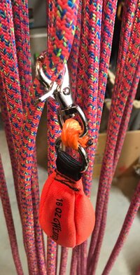

I pull the bag up to me and clip it to my belt. It's great for throwing ropes in the canopy and helps with flicking them back down. I take off the throwline loop and use it for joining climbing line to tag line, like if I want to take the last top and it needs a pull, I can just replace my climb line with a tag and send it
