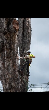

Those Kiwi Klimbers look sexy AF!
They really are Erik. A big improvement over the OG. My OG delaminated after 7 years. Got my monies worth. These were Dale's back up pair he sold me. They were new though....as he did not have a production going. Doubt I will ever own another pair. Not sure what is going on with the biz these days, but one cannot get them anymore unfortunately. Great concept.

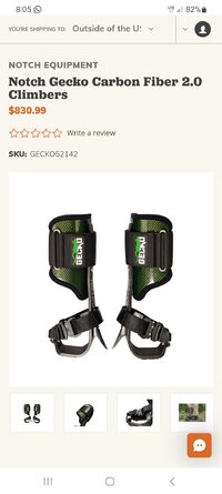

I am in the process of gearing up for the final run of my climbing career and keeping the weight down on gear is very important as I get older. Getting ready to pull the trigger on some carbon fibers ( distel, gecko?). Sure which Dale was still making the Kiwi's..
Those new Distel CF are pretty much identical except pads. Very very nice I think.
I think these stirrups seem a tad straight, I prefer them with more bend. Gives more comfort, you would understand this way more than I.....am I correct. Spurs are not my strong suit. I just get on with it. The straight geckos were painful.....these KKs and OGs were so comfy.
