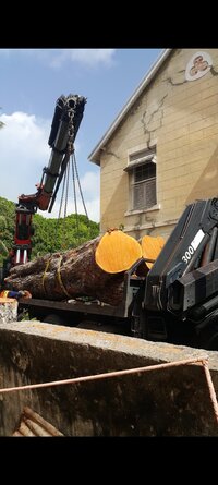

I want to state now, that today no way am I slinging that size wood with one sling. That one was too long too. It will be double slinged on opposing sides and shorter slings with hook over COG. This was over COG but just had to clarify things. Today I am so much more careful and way more experienced, to not let folk rush me. That job was rushed in my opinion. My buddy was paying for the cranes used a PK 150 too for butt log.

Yesterday I was ddrt off crane hook setting crane slings on very long heavy limbs in a tree every bit as wide it was tall. I was on a rope wrench setup with wrench clipped back on standing end of line. Once rigging slings were set and I made obsurdly long limb walks back towards inner crown for my cut point. I'd lanyard in and toss my line up and in over a suitable union .On this cut, I could not retrieve the line to re tie in,, so monkey fist formed I flipped line down and let line to ground . Highly trained ground support staff would basal anchor for me ; ) , I reclip the wrench enable. I like how the RW can do that. If I can retrieve line in tree I'll canobase anchor myself usually or send line down and quick link midline so standing end waiting below makes retrievable. This method saves my climb line a bit from getting roughed up natty crotch or sapped up. That's about the extent of my ddrt an srt blend. But the RW is perfect for switching back and forth.
Yeah that had to shake rattle and roll coming off !
NAh, I can use one sling a lot. Mostly vertical wood. Prefer pieces to be in the 2000 to 5000 range. This came off smooth as I recall. Only the butt gave trouble and that was because the 150T was maxed out. It was around 25000 lbs...9' DBH 25ft tall easy.....went out on another knuckleboom. Screenshot_20230131_115837_Photos.jpg
