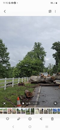

Here's a couple still screen shots if the fall. The stub is clearly past the padding log and impacts directly on the blacktop.

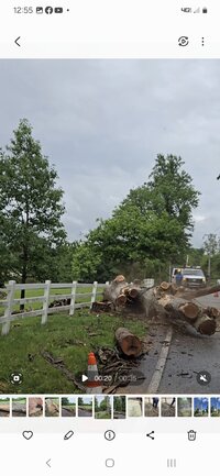

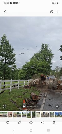

also prevented any of those massive stubs you left from digging in and stopping this log from rolling into the fence
There were no other "massive stubs"..
certainly nothing that would have stopped the rolll.
By the time the big stub rolled to hit the ground, the falling log was off the padding logs
