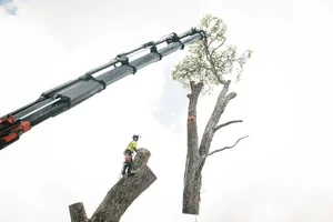

I am self taught at crane work using knucklebooms only. Have never used a stick because I am usually craning in very tight spots. Thankfully we have huge kbooms here. That being said TRAINING should be a must for all crane virgins in this modern era of treework. The training is easily obtained and well worth it. Easy to be killed or maimed for life doing it. 2018-06-20 10.39.34.webp
