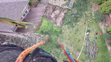

Thats a cut I call a V cut for obvious reasons. You usually can see that if your slings are not 100% balanced, it will either shift in one direction or the opposite. I use this cut to help lock it in so neither can happen. I don't like to use button lines and this was my way to get around that.
Could I get an explanation of the benefits of this cut. Just curious. Thanks
Nothing amazing just thought it was neat how the buddy got the rope angle captured in there.
Lol. I know, sorry just don't get it.
Most picks will possibly move in one direction or the opposite direction based one structure and the tension of the slings. If you see this, you can angle the V cut to lock in both movements. This gives the operator all the time in the world to load up after its off and it limits any movement or shock. Make sense?
So it's not meant to stop the movement, just to stop the butt from coming off the cut until its settled?
Once the V cut is made its kinda like a traffic cone stacked on another traffic cone! It can't move side to side, the only way off is up.
