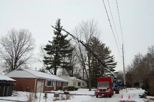

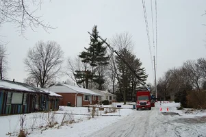

Hey Tierson, can't wait to see your new crane! I haven't used the Rig & Roll with the 1750 yet...but maybe soon. (sorry i didn't see all these replies on this post) I've had the 1750 in 7 out of about 20 driveways so far & haven't had any cracks at all! Xman, the load chart you posted was for the"L" version, but mine picks twice the weight at 100 foot radius as the "L" model. Mine will be getting extra manuals on the end of the jib to get about 130 foot radius but will only be good for about 1000 lbs. It will have to be load tested when the extensions get here. So far the load testing has the crane running 10 percent over max before any alarms go off (it can do this because of the X-style out riggers

This crane came with a digital wireless load cell unit. It consists of a special hook (that some kind of antenae sticking out of it) and a small read out box that velcros on to the side of the remote (hardly something that will stick on during tree climbing) So i haven't used it yet but plan to (i'll try to get ya' some photos) With the kind of wght the 1750 throws around i don't have to calculate on some picks (as long as you know you're well under chart)
