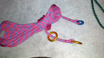

Yale Kernmaster splicing
Sometimes I get on a roll, other times I crash and burn.
I really should be using an awl like Nick showed off. That would make the picking much easier. Sometimes I feel like the Joker's plastic surgeon... with limited tools, making a freak show of a splice. I splice a smudge under the amount of time at which you'd want to build a nice work station and invest in tools.

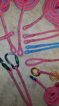

I have been able to do 12 kernmaster splices to date. It is not easy but they are much better than knots. I use kernamster in a ddrt setup with a hitch climber pulley. The knots get in the way of the hitch.
I use class 1 double braid splice instructions. I use a samson 7/16 fid for measurements. Do the cover bury first. Count out 8 strands and then start the cover taper. One pair every 5 strands after that. Taper the core before the core bury. I use a piece of #12 copper as a wire fid for the core bury.
The thing that is different in my splices is that I use 6" between marks for the eye but I pull the crossover several inches down into the rope making a tight eye. I also shift the extraction mark on the core back 4 inches. If you do not do this you will not have enough room to bury the crossover. This rope have a very thin cover and it needs to be bunched up a lot to make the bury.
