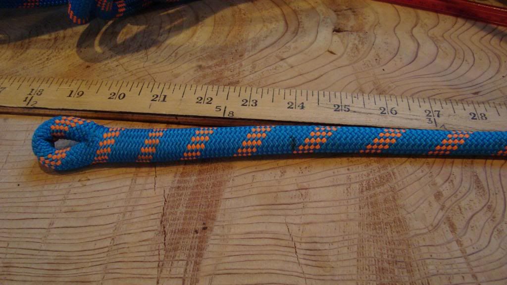

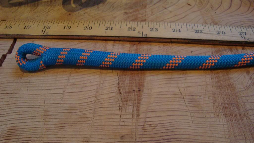

So I did it. I'm still waiting some sort of confirmation from yale on measurements. Oceans thanks for the help. This is the 11mm and I did a 6 1/2 core bury. Is a little deeper than the mark on the cover, I entered about 1/2 to 3/4 up the rope with my wire fid. I have the slightest amount of bunch on the cover in the eye.
I like the work, evo. It looks real nice. That bunching in the eye looks to be the firm nature of the jacket, unless there's slack in there, which doesn't appear to be the case.
I looked back at Nick's photo of the Safari Kernmaster, but the eye is in a dark shadow...kinda hard to really tell, but both look great from what I can see.
Getting the core out is a challenge compared to 24 strand, for sure, but I also had quite the challenge getting the core to tuck through the jacket and bury.
