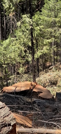

The last stage of the Camp Fire cleanup began this week. Today my buddy and I got sent down into this canyon to cut the last of the standing dead. The Feather River is down at the bottom. I hear we have another lot on that road, so I may try to sneak in a 15 minute swim break if we get close enough.
