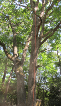

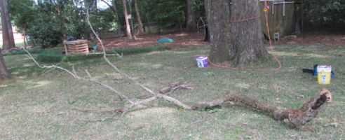

Spent a pleasant evening doing a dead limb removal from a wonderful big oak tree.
Rigged it from high up and further out, cut it with the razor saw, and lowered it well clear of everything while I was in the tree.
I was planning to use the chainsaw, but changed my mind when I wasn't able to get my lanyard around something suitable for chainsaw work. Cutting the part that wasn't rotten yet was a good workout.

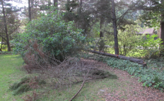

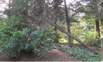

This leaning Leyland pine was just tall enough to hit the house in the direction of the lean.
I rigged it to the tree to the left so it wouldn't land hard on the Gardenia bush when I made the cut.
I was able to remove the limbs that might damage the Gardenia before lowering it all the way.
Then I cleaned it up with no damage at all.

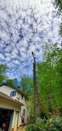

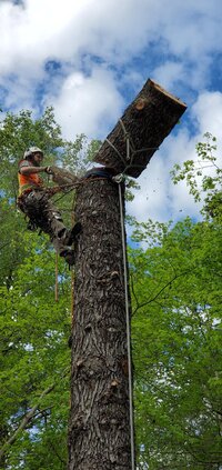

I’m likin how close that first half hitch is to the block. Nice work. Looks like some good pretension in the rig line by the way the block is poking out as the piece is coming over. Undermined COG on that face cut?
There was a time I would leave my positioning lanyard under the block like that. Now I reset it above after tying off the block.
Thanks for the complement Oceans. I've been doing deeper face cuts on larger diameter pieces for a few years now. I think It's easier and faster to let gravity tip it, then to expend a bunch of energy attempting to push a chunk over.
I prefer to have my lanyard under the block sling for two reasons: it won't pop off if there is a violent shock load and it sequentially makes more sense.
