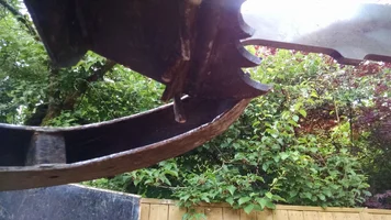

BMG trick for you...
Your right they both have their place, I was all set to sell my mini skid after buying the Avant but think I’ll hold onto it as I don’t think the avant will do good in our snow here, plus running 2 crews each crew has a loader. The great thing about the avant is the lifting power, height we can load logs with the telescoping boom is phenomenal! Also not having to lay mats down on nice lawns is such a time and labour saver you can pretty much turn on a dime with the avant also, still getting used to the BMG though as I’ve been using a Vermeer grapple the last 6 years. But whatever decision is made having a wheeled or tracked loader that does the work of 3 guys is undeniably unbeatable!
Pushes without grapples dangling.
