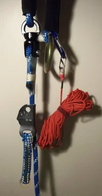

For a really low friction setup that I set in the canopy that is retrievable I like this one that I made. That tiny biner won't go through the pinto, and the revolver is good at not getting stuck.

I'm liking the revolver/pinto thing.
Hafta try that out so I can midline install a sweet knot block canopy anchor off of a base tie ascent.
Chyea, bra!
I can keep the components on my saddle seaprately and completely useful, and toss them together if I need them.
Those little dyneema slings are beautiful.
That could be a cool idea. I'm going to have to mess with it.

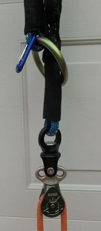

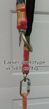

My favorite, currently, is this one... technically, a canopy anchor that can be installed and retreived from the ground, works for SRT and DdRT both (with one change).
It's shown here for SRT, with the climb line installed in the swivel. For DdRT, a pulley is installed in the swivel, and a throwline put through the pulley. Installs the same, and then the climb line is pulled through the pulley with the throwline. The 1/8" red line is the retrieval line in both configurations. For DdRT it's easiest to just pull the climb line out with the throwline tied to it, and use the throwline to help bring the anchor back down. That way, I don't have to drag the climb line through the crotch.
This is a prototype I had the nice folks at TreeStuff put together, because I can't splice kernmantle and I was getting all the components from them, anyway. They were able to decipher my construction requirements perfectly, assembling the hardware and two layers of chafe sleeve onto the 1/2" KM-III when they did the sewn eyes. I'm sure they probably thought I was nuts when they saw what I wanted them to do, but hey... I'm extremely happy with the results.
It's about 4 feet long. Ignore the ascender, it has nothing to do with the device.

I've seen this device several times now.
This is the first time that I remember hearing about a pulley for ddrt on the swivel. What pulley do you use?
Can you come up with a picture for me?
I get the premise, I just haven't used that sort of swivel before and kind of want to get a feel for how it looks all set up.
I'll do that, man... my other iterations of this concept use an OmniBlock 1.5 for the pulley, but that's kinda redundant on this one, since it already has the swivel. I'll dig out the pulley I use with it tomorrow and post up a pic. It's wet, dark, cold and drizzling out there right now (gotta rummage through the equipment trailer). There are some steps you have to take during the install/retrieval process, but it's really no more complicated than a lot of other similar ideas for redirects and canopy anchors I've seen posted. After doing it a few times, it gets to be second nature and you don't have to think about it too much.

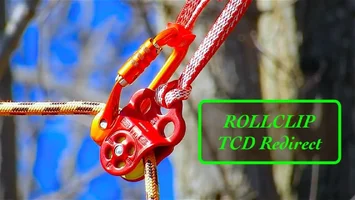

image.webp Thoughts on this? Specifically the Rollclip, isn't it rated at 20kn?
I like the size of the Rollclip over the Revolver but at 20kn isn't that slightly shy of the life support minimum?
View attachment 46045 Thoughts on this? Specifically the Rollclip, isn't it rated at 20kn?
Not for half of a life load.
The teufelberger slaice is like 15kn I think. Individual side d rings are 15kn on the treemotion.
Several 8mm hitch cords don't pass a straight pull but are allowed when used as an eye2eye.
I'd have to see how that setup interfaces before I trusted it. I'd rather have a pinto there. It's a cool idea though.
Since this thread is bumped, I'll just throw out there that several guys beat me to the pinto revolver idea, and I think it was worthaug that posted the superior setup where the webbing is captured by a biner through the pinto instead of being open to being crossloaded.

Sorry, I forgot about this thread for awhile. I've tried a number of pulleys in that thing, but I usually use a ROOK even though it already has a swivel. It just fits in the canopy anchor's swivel shackle well, and doesn't mind being dragged through crotches.
canopy-anchor-ddrt-1.webp canopy-anchor-ddrt-2.webp canopy-anchor-ddrt-3.webp canopy-anchor-srt-1.webp
Any pulley you feel safe on, that fits in the shackle and will pass through the large ring with a little wiggle room, will work. I've used OmniBlock pulleys up to the 1.5" one, and various others, but the Rock Exotica Hydra/Rook is the one I settled on.
