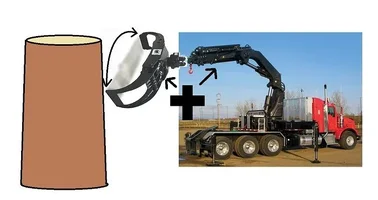

I've been thinking of a grapple mounted on a Kboom for years now. Not a conventional grapple, which hangs with gravity, but one that sticking out (inline) with the boom. However, it could rotate to accomodate different angled limbs.
Therefore, the climber would fly into the tree the initally, then the climber would only have to navigate to the next cut. A groundsman could move the boom into position while the climber is getting ready.
I pieced out two photos to grossly illustrate what I'm saying. I think it is easy to understand.
Here is where the Kboom owners could spike my idea (since they have hands on experience with a Kboom. I'm merely dreaming of scenarios).
***With the help of a jib, couldn't the loads be placed into a horizontal position, to the ground? Would this create torsion to the boom? Would this fixed grapple create added leverage on the boom?

Let's use a photo from Mike. Remember I'm picturing a fixed grapple head that can only rotate. If we're really confused as to what I'm saying... place a beer in front of you, on the table. Reach out and grab it. Pour beer into glass without flaring out your elbow. That is the motion I'd be describing.
So, in the photo below, after the cut is made the boom will rotate towards the chipper. In order for the but end of the tree to face the chipper the load would have to rotate 180°. Main boom extend quite a bit and the jib down 90°.
If the chipper were being in tow by the Kboom, the load would not need to be rotated 180°. It would simply be placed horizontally behind the chipper. Heck, it could stuff the limb into the chipper!
IMO, if this set up could work, it would change the way we know tree removals... At least with Kboom accessible tree removals.

Jamin The grapple would need to be able to knuckleto make it most versatile. The angles and bend of trees would most likely make it sifficult to line up at times. you would definately need the fly jib.
