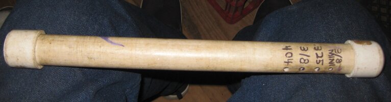

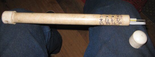

I would consider this an accessory to an 'in the field' sharpening set up. 3/4" pvc. Precision holes for measuring file diameter drilled through both walls of the pvc (easier than reading the little numbers on the file). Numbers burnt into pvc with a soldering pen, then black magic marker rubbed into the groves then steel wool to remove marker not in the groves to clean it up. Files each gets their own drinking straw.
This is an idea I borrowed.

I use triangle files on everything except my real small stuff so no need for the numbers but that's a great way to store/keep them safe.
