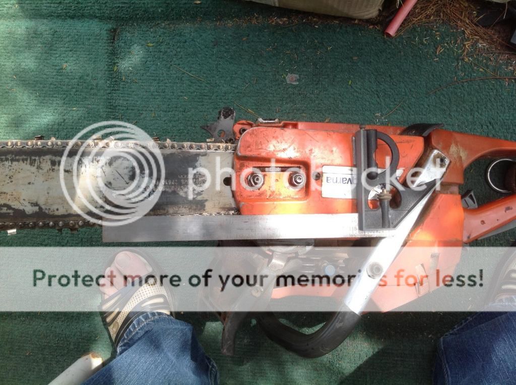

I use the handle for sights. Does anyone use the actual sights?
[/ QUOTE ] using the handle, like ropeshield mentioned earlier can throw out your aim if there's lots of play in there, unlike the actual sights which are 'fixed' once the bar is tightened up.
I'm curious about just how much slop is in the bar stud connection itself?
Each time I put a bar on I have to lift it before tightening the nuts down,
Considering the chainsaw sight itself is only maybe 5-6 inches long, it seems the potential slop factor still exists.
I believe this may be why Tom Craven preferred using a large carpenter's square to sight all of his extremely critical tree felling.
Three feet of sighting edge to look down has to be better than 6 inches for a precision drop.
jomoco
only on the 200t, it doesn't have lines
It has lines on both sides Dan, same as the 201, look again
It sure looks to me as if my husky bar is out of true by the exact amount of lift I get when raising the bar prior to tightening the bar stud nuts.
Which begs the question of whether the husky design engineers failed to off set the bar studs enough to compensate for that slop?
Which also begs the question of whether the designers at Stihl also made that same fundamental error?
I've no doubt that both husky and Stihl bar studs are true to their sights.
But that does not mean the same is true of their bars once raised and tightened?
I need some independent analysis of this phenomenon guys.
jomoco
jomoco
The bar is curved, dont forget Jon
I always tighten my stihl bars with the bar setting down with the saw in the upright position. I treat the sights on my saws just like the ones on my rifle. When you are familiar with the saw and know the bar is true to the sight I know i will hit my shot.
Well I just got independent confirmation from my Stihl dealer that what I'm seeing is accurate even on a brand new Stihl saw.
But it's his opinion that neither Stihl or Husky will give a flying hoot about their sights being out of true with their bars!
Amazing!
Oh well.
jomoco
Amazing!
Oh well.
jomoco

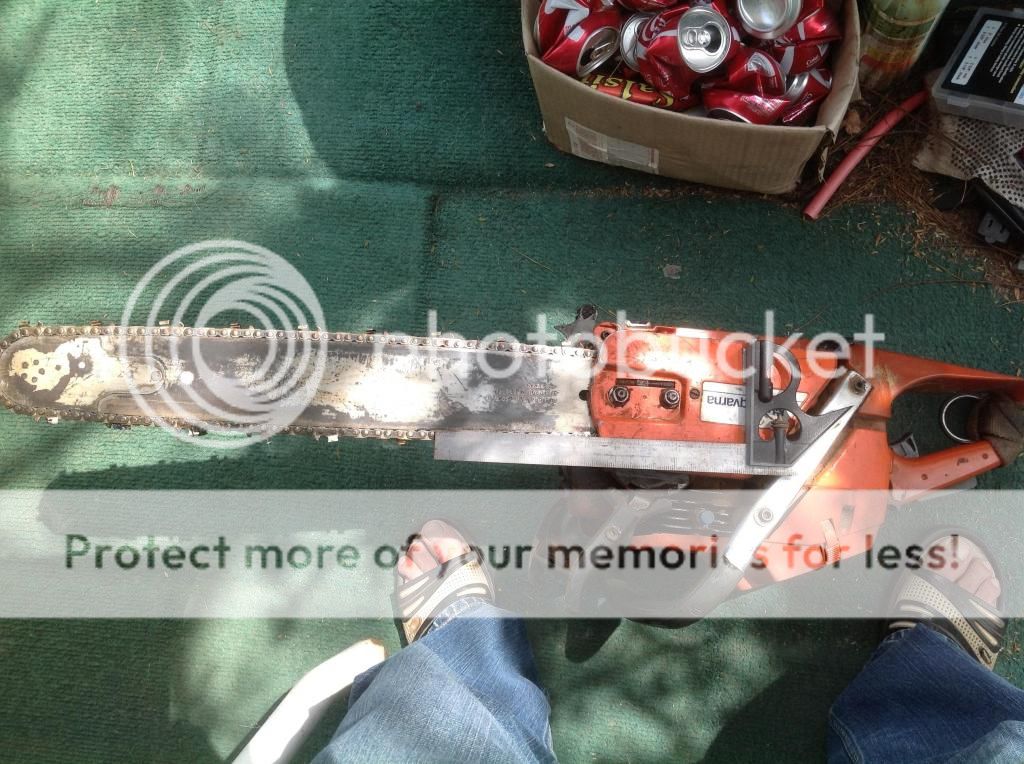

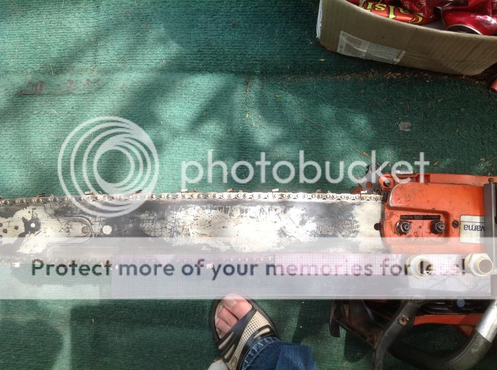

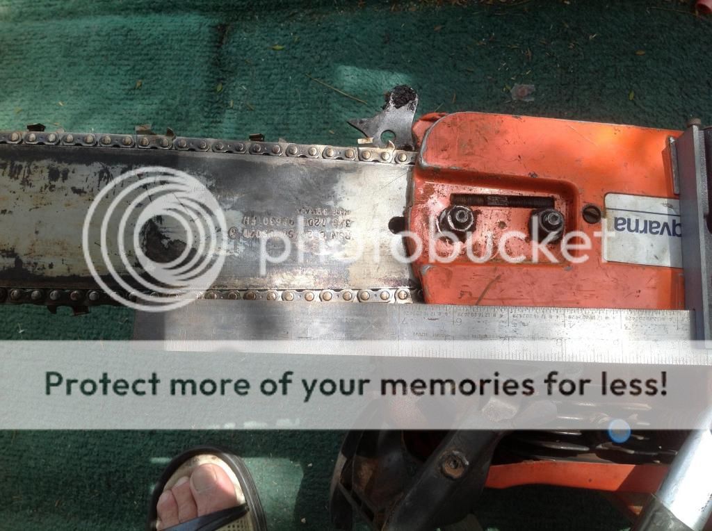

Line the square up with the under side of the bar Jon, and along the whole of its length, not just the nearest quarter. For accuracy, you wouldn't use such a long bar in the pic for a tree only as wide as what that square covers.... but if you had to then you'd use the middle of the bar.
Well the Husky expert at Baileys says that he's known known the sights on both Stihl and Husky saws are crap only used by amateur loggers for decades as well.
I guess yu learn somethin new everyday guys!
jomoco
Not only did the Bailey's old dog expert say that, so did my old time logging expert that now runs my local Stihl dealership, an old friend of mine, along with his younger brother who used to sponsor our local tree seminars.
I tend to believe these old timers know exactly what they're talking about.
My apologies if I'm cluttering up your thread Reg?
jomoco
