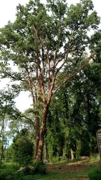

I spent over 10 hours removing english ivy from a 100', 2 codominant stem white oak. The ivy goes all the way to the top on everything, heavy girdling. It was volunteer work for a wildlife sanctuary. Hot summer Georgia day. So I'm digging for expertise in removal techniques. Work had already been started a few months back and the ivy is dead.IMG_20160716_51805.webp
I spent over 10 hours removing english ivy from a 100', 2 codominant stem white oak. The ivy goes all the way to the top on everything, heavy girdling. It was volunteer work for a wildlife sanctuary. Hot summer Georgia day. So I'm digging for expertise in removal techniques. Work had already been started a few months back and the ivy is dead.View attachment 38790
Wowzer Richard, look like a PITA! I admire your perseverance, especially volunteering for this.
