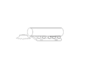

We've used tires and 3', smashed down brush piles; anything with proper give will work to de-accelerate. Sometimes i place 2 logs pairalllel with the lay, then trestle other logs across. Notch the up side and start a backcut on the bottom side; leaving cut only 1/2 way or so.
The idea is if it takes 1000# of force to snap the log, that is 1000# not transfered to ground/ dissipated; i call it a mechanical fuse of sorts. felling across logs also can spread out the foot print of the force too; in addition to the 'blowing of the mechanical fuse' dissipating force.
