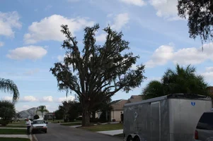

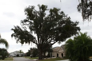

Without stealing the thread as I feel this relates to the subject, I am attaching three photos of a project of mine. The crew and I reduced the load using reduction and removal cuts.
The goal is to take a tree that was lions-tailed twice and is extremely off balance and tip heavy after removing the forest around it. It was full of Mistletoe in the outer canopy. This is odd in a Live Oak (Quercus virginiana)as it seems to happen under extreme stress.
The mistletoe seemed to be at natural shedding points of a restructured canopy but this is a story for another thread.
My goal is to use the natural lines in the canopy to retrench and regrow the canopy over the road. This tree has been struck by lightning twice since construction.

Approximatly 20,000 lbs of material was removed from the canopy.

Cambistat was added. Feb 2013
Arborjet - Phosphojet was injected Mar 2013
This is 5 months after pruning. Picture taken June 2013.

"Without stealing the thread as I feel this relates to the subject, I am attaching three photos of a project of mine. The crew and I reduced the load using reduction and removal cuts.
Man, you bumped it up! Nice looking work. The after pic looked scary, but it sure did respond!
