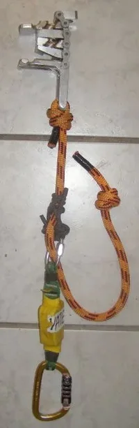

A couple of years ago I crossed paths with Morgan at TCI Expo in Long Beach. He had just made his first version of the Uni. When I got home to try out this new tool I fell in love with it. Finally, a way to ascend and descend on a single rope with the same tool. No switchovers needed. That version wore a bit and the rope slipped. Morgan designed a solution using some small pieces on the leading edge of the bars. This wasn't the best solution because the Uni couldn't be dialed in very well. It went from lock to drop too easily. No feathering was available.
http://www.thompsontreetools.com/
Now he has the bugs worked out. Adding the radiused lips to the bars has made the tool so smooth use. For the last few weeks I've been using the Uni exclusively. No DdRT work at all. The trees that I've been working in have tie in points from 80-100 feet.

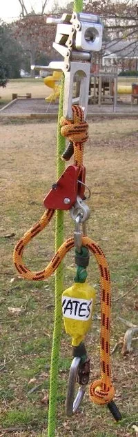

My ascending system is sort of a Frog setup. The Uni is my upper ascender and is attached to my harness with an adjustable bridge. In the pic I have a small screwlink. This didn't work very well so I changed to a bowshackle.I think that the best setup would use a delta link to keep things fair. This setup has promise. This morning I got the idea to use my Positioner as an adjuster. In the next couple of days I'll have reconfigured.

I'm unfamiliar with a Yates "Screamer." What role does it play in your setup. Also, do you adjust the length of your Unicender setup (short piece of Blaze w/ micro adjuster) much? For what reasons? Ascending vs descending?
