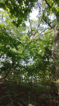

Here’s one hung up at about 60ft with another 30ft entangled. The base is 24-30 inches. The owner wants it pieced out with minimal collateral damage. The other tree is100ft+ and 4-5ft, big tree. I’m getting worn out just looking at the job.
