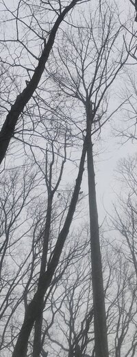

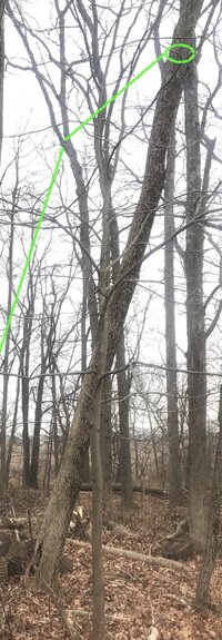

This leaner is a bit bigger than it looks in the pic.
The illiustration w/the green line REDIRECTED is what I SHOULD HAVE done. But I ran it straight down to my pulley system. Far away, which I thought would soften the angle enuff - but no. Eventually I realized the angle was too oblique, and I was pulling downward on the stem, more than anything else. I was not able to free it that way. Ended up loosening the tension, but keeping the line on for control.
I thought a notch on the topside and a hinge cut from underneath would let the leaning weight simply collapse and fold, but while working that cut (about a foot or so off the ground - normal felling height) I could feel the weight was just pressing IN, and it wasn't going anywhere.
So I gave up on that. and, a few feet higher, I progressively cut two notches, top and bottom, to get a feel for which way it wanted to 'fold'. I made very wide open cuts to prevent pinching, shaving it down. (Thx for the illustrations for the special cuts for leaners. Appreciate it!!)
Still, there was so much weight on the stem I was worried the saw would pinch when I cut thru, so I finished w/a Fiskars 36" splitting maul. I also tied off the bottom part of the stem (under my notches) w/a safety line to a nearby tree. I couldn't be sure if the weight was going to kick the stump towards me when it let go. The bottom was really rotted out and it could have gone in any direction. With an axe you gotta get pretty darn close! I didn't want to be inna cast for 6 weeks just to make a few hundred bucks.
