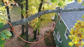

I used it yesterday for the first time.. only on a few cuts.. bombed almost everything.. It's awesome.. though it has some significant issues, depending on rigging styles.. I use a lot of redirects and switch ends on the line frequently etc... . I prefer more flexibility than a splice would allow.... I used an anchor hitch on true blue and clipped it to my saddle when it came off... Little heavy for climbing.. perfect for the bucket.. more later..
Had to put a 2500 lb screw link on the choker.. I didn't actually try to put the anchor hitch on it.. just looked like it would interfere with the hook.. The crew link was $9 and it significantly reduced the strength of the system. Not concerned about it though as I only plan on using it for fairly light rigging.. say under 5-700 lbs....
