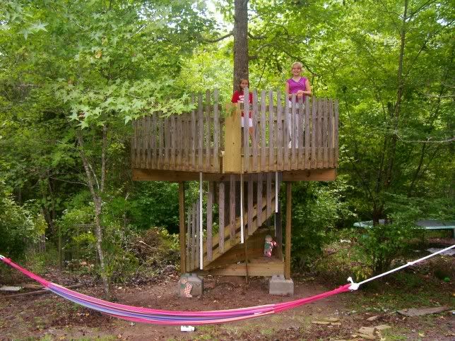

This is a picture of the tree house in our backyard I made for the kids. The platform is supported mainly on two footings but the double spiral stair supports are bolted to the stem of the tree. there is a trap door at the head of each stair.

This tree is a sweet gum, (which makes for good ammo). The TH is about 5 or 6 years old, so far so good.
