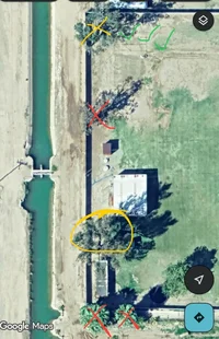

Reds are dead and gone. Yellows not healthy. Yellow circle has the widowmaker limb.
Green checks are volunteers, I think I will recommend they be transplanted.
Consider leaving those established volunteers and transplant trees from elsewhere.
Your climate is tough.
Small trees go away in a blink of the eye but take a long time to get established and growing.
I more or less agree but come from the mind of using a tree spade to move a small enough stem with a large enough root ball to limit stress.
