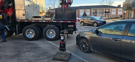

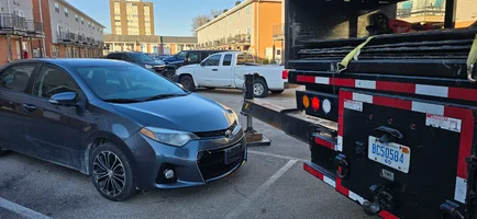

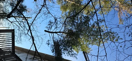

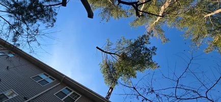

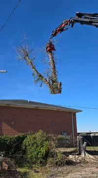

A couple of easy setups for multiple easy trees today, followed by a tight setup for a single limb. The apartment complex chose not to have the parking spaces cleared that we needed, so we went up and over the three story building using a few spaces that happened to be empty.

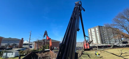

What do you think ? Game changer ?
I know he will get much faster at it, but the first job we did on Monday, I believe would have been faster with his 50 ton stick crane.
That said, I don't think that crane would have gotten level where we had to set up. But it was a tall Oak with a good reach over the house. And over 110° swing to set down debris. Basically full extension out to reach that job, retracting back, large swing... added time to each pick while also taking the size of the picks easy while getting a feel for the truck.
Friday's job was a better setup for the crane, with the truck sitting closer to the trees and the trees were smaller. Basically a good day of repetitions for him learning the controls with minimal risk/stress.
Both days we worked with just the two of us, him running the crane with mek head, I ran a ground saw, mt100 and grapple truck.
A nice advantage, even when running a skeleton crew, is that I could leave to unload the debris truck and come back to a smaller tree almost done when I return 30 mins later, with him working solo.
So the set up if I’m not mistaken your saying would not have been achieved with the 50 ton stick crane but was fine for the kboom?
You performed a couple descent sized jobs with just 2 men and you could go dump while he kept at it so one man solo dismantled trees safely with both feet on the ground.. sounds promising
Yes. Some of this is due to the stick crane works off of the back of the truck and this knuckle works off of the front of the truck. The front stabalizers on the knuckleboom set at the width of the truck and the rear outriggers of the stick crane are nearly 40 feet wide. Allowing us to set up around landscaping closer to the house than possible with the other truck.
Also the knuckle has a shorter truck chassis and shorter wheelbase by several feet.
That's correct. And efficiency wise. I am comparing 15 years of stick crane experience to 2-3 jobs with the knuckleboom. I expect efficiency with the new crane to only go up from here.
I’ve worked a lot with a very similar 63 mounted in that same position on the truck. This one here new to your crane guys in photos chassis actually looks a touch shorter than my friends and I know he can get into some tight spots and set up to work. I learned a lot about short jacking and still working safely from him
We haven't short jacked this one yet, but its been rock steady so far working in any direction off of the truck.
