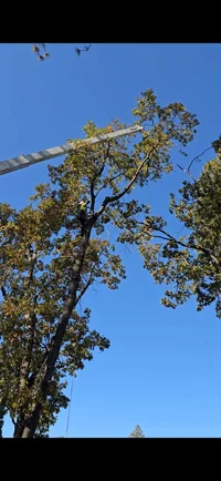

Got to do my first non-conifer crane picks yesterday removing three funky black oaks out of a backyard. They all stayed really nicely balanced when they came off, so I was on cloud nine the rest of the day. On this first cut, my boss was worried that the tip was gonna dive, but I felt sure of my placement. Felt really cool when it floated away silky smooth.

I do have to ask though…and not criticizing you…that boom is pretty well into the brush. Maybe it just looks that way? Must have been a real long radius. Most stick crane ops I know don’t really love doing that. I’m sure you guys talked it all out.
How many slings were you flying and what length? Must have been nice to get those tops out and work the lower portions with more scope.
This guy gets plenty of tree work all year long, and has been working with my boss for many years now. He is super comfy basically running blind and just working with directions from the climber. I was running 12' flat nylon choker slings, mostly just one per pick, except for the two times I took both sides of a union together, and I put one on each side. I have definitely been involved with some crane work, and done a few different crane jobs now, and I have worked with this operator several times myself now, so we each have a good feel for how the other works. He actually has a lot more experience in that specific work flow than I do, so he was been able to give me a little guidance when I first got to go up.

That relationship is very important. It can be hard to build trust with some guys, especially if one is bringing a different approach to the matter.

This sounds very similar to my crane operator. We typically run 14' nylon slings but otherwise the same.
My op doesn't mind the boom in the brush a little as long as we are watching his LMI cable closely. He'll boom up and cable down for clearance once the pic is off.
