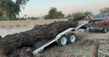

IMG_9128.jpegIMG_9181.jpegCut these down sat. Went and winched the logs up on the trailer today. Unloaded them at the shop and loaded Euc FW to sell to guy I’m also cutting down a dead Euc for. The mesquite will probably get sold as decorative slices or “cookies”. Maybe salami cut into charcuterie boards, etc.

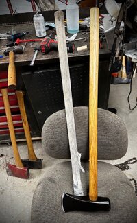

Saturday customer gave me this old 8lb maul, rehung it for my son.

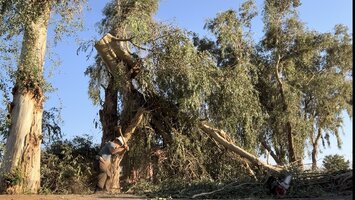

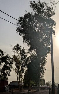

So….50’ lift wasn’t enough to small
piece this thing down from the top without getting the power lines. So, I took off the back limbs I could reach, left two big ones on the front, and topped it or gave it an extreme high stump. Made myself a bit of a widowmaker on the tree it landed on, but the sun was setting and I wanted to get the lift work done today so I could bring the truck trailer and forklift to load it all tomorrow. Probably could have felled the whole tree, but it would have bounced off the others a bit.

Winched on tilt trailer

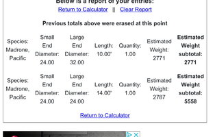

Madrone is close to Euc right?
