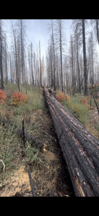

I used the snipe on this spar for 2 reasons. Since I had to high stump (shorten) this spar to clear a water line the snipe helped the butt to sit down. Secondly the spar was fat, but short, so the snipe help the spar get enough forward momentum and speed to power through the hinge. The snipe combined with a slightly gutted hinge mitigated the chances that it would come to a stop as the undercut closed up.
The only advice I have on using snipes is to always remember that they can and will influence your lay, so you want to make sure they are squared up with your undercut.. I do this by simply using a log tape to measure out from the intersection of the undercut. Scribe a line and the snipe is perfectly squared up and will not have a negative influence on your lay.

Right on, thanks for the explanation for that situation and the advice on its need to be square to the face.
I have wondered how much an obtuse snipe can influence the lay- purposely or accidentally
