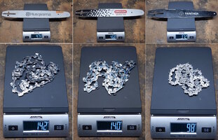

Speaking of it, I just installed the Oregon SpeedCut Nano on mine tonight, and... maybe I wasn't paying attention before buying it, but it seems exactly the same as the stock bar and chain. Essentially the exact same weight on both the bar and the chain (I weighed them), and same pitch/gauge/tooth count/sprockets. So far hard to imagine it is going to be any different in performance, but I'll try it out and see..... With three different B/C combos for it, I should probably make some kind of comparison video...

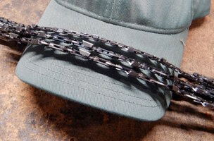

This and its associated discussion probably deserves its own thread, but I'll do that once I've got some actual cutting time on the Oregon setup. I'll just quickly say the weight difference between the stock and Panther setup makes a big difference in the feel of the saw, and the acceleration of the chain. All the more reason the SpeedCut Nano seems pointless so far on the T540i XP... But I'm not a big fan of the Panther chain, which is the complicating factor.
