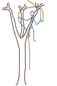

Maybe I've been slow all this time, but today I was setting a natural srt redirect and realized that if I just pull the bight through and then send the tail down my next redirect, that like a ponytail retrieval, I can retrieve to a new redirect while removing my last one, and work my way up the next section after working down the first.
I've used this method countless times to remove a redirect, but never thought to set it up to make another one as it was pulled out. Again, this may be common knowledge to most, but I thought it was worth mentioning.

Please elaborate. Not sure I'm fully pickin up what you're throwin down

Instead of pulling all the line through a natural redirect, leave the tail on the TIP side of the union. Then take that tail and send it through another fork that you want to use as a redirect in the next section. After working your way down the current section, get to the tail now hanging in the next section. Break down your 'cender and pull the tail to take the bight back through the first union. You should now have a straight line from your TIP to your second redirect, then down to you. Now you can start working your way upward to the redirect.
I hope that helps. I'll try to sketch it sometime this week.

My turn- I think I'm close to grasping that one, but need a little more help.

Instead of pulling all the line through a natural redirect, leave the tail on the original side of the union. Then take that tail and send it through another fork that you want to use as a redirect in the next section. After working your way down the current section, get to the tail now hanging in the next section. Break down your 'cender and pull the tail to take the bight back through the first union. You should now have a straight line from your TIP to your second redirect, then down to you. Now you can start working your way upward to the redirect.
Crimsonking's:
Macswan's:
I did these in Microsoft Word. Not even sure I got the described technique 100%, but I thought I'd try to help.:sisi:
