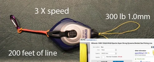

Other day I was setting lines in a very tall tree, 170' white oak, up and down with a throw line just to bring up another throw line.
This reel will hold 200' of 1.0 mm, 300 lb test braided line. 3X speed in winding. A 10oz weight will pay out about a 30' foot throw.
This reel will hold 200' of 1.0 mm, 300 lb test braided line. 3X speed in winding. A 10oz weight will pay out about a 30' foot throw..
I love the 3x winding speed. That looks like a great little reel.
I'm not sure I follow the other parts of your post. Were you setting lines with a big shot? from the ground? If so, why use a reel? Were you having to use fishing line, then pull up throw line, to then pull up climb line? Sorry if it's just me--maybe not enough sleep
This is how it was going.
Set the first line with the Bigshot, about 160' into the tree. First climber goes up to set lines at various places in the tree.
My preferred method to get as many lines set in the least amount of time is as follows:
I drop a small weight with this reel, when it reaches the ground a long throw line or two tied together are attached, these trees take about 350' of line. The end of that throw line and weight is reeled up and then tossed over a suitable isolated anchor. The ground person lets that end to the ground and deals with it just like it was thrown there.
Much faster than setting each line from in the tree, although that seems to happen a lot, just takes a lot of effort for the person in the tree, hauling up 160-200 feet of line, tying it off and then dropping a throw line for recovery.
Also it means I don't have to physically get to each anchor to set it. Sometimes moving around these huge trees is a real challenge as the limbs are very far apart and the diameter of a VW bus.
