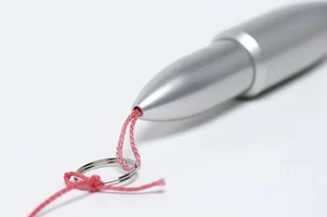

Here is a pic showing how it can be done. YTube vid shows how to do it with a fid but Usually I don't use the fid, generally the loop or the line can be thread thru quite easily. Some of the older models have smaller diameter holes that can make it trying. insert the fid thru small hole then pull loop thru and attach your choice of connector.[ QUOTE ]
Treebing
Thanks for giving it a throw. Like to give you some help with this because it is a completely new throw weight and the first time through can be interesting.
It comes with a short loop of dyneema so you can use it exactly like a throw bag you just need to install the loop through the tip with the wire fid and then you have a place to connect the biner or split ring it came with or you can use what ever you already own clevis, maillon rapide, what ever you want and then it is ready to throw like Just like the classic bag.
Here is video link in very tight backyard shooting and throwing RopeKnight http://www.youtube.com/user/Ropearmour Check out Traditional Throw Vid and the RopeArmour fired from BigShot
pic shows it tied the traditional method
Almost all of my work seems to be in tight backyards with lots of random garden ornaments everywhere. THere is a place to tie it on the back, but the video and the dierctions say to tighten the line on with a screw. Quickly decided that was not happening for me.
