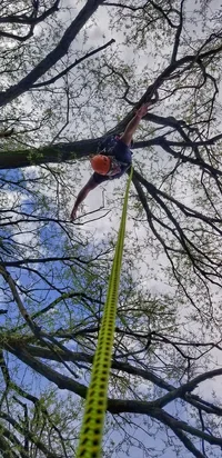

This is the Akimbo
Hey, Raven, that is a truly great photograph! I'm assuming that that is you. If so, sir, you are a beast! I think that this photo should become your avatar pic. Thanks for posting it!
Tim
Ha thanks Tim but I could never get rid of Arcimboldo's "Winter"
@RyTheTreeGuy that first pic is sweet looking straight up the rope like that, magazine cover worthy.
I guess I had withdrawals from this thread, just couldn't let it lay dormant. FWIW the Akimbo is my go to device on Every. Single. Climb. It is truly an amazing device and for those who don't like it - I think they just haven't given it a chance but hey at least there's more on the market for the rest of us.
Let's see more Akimbo action pics!
