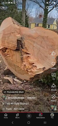

Here's a good example.. this tree was right next to a garage and well within striking distance of the house, but it was straight and when using a high pull line and the loader, there was zero chance of failure. The hinge is only as fat as was needed. If there was any appreciable side weight, I would have left a fatter hinge in the tension side of the tree.
I used the center plunge here for convenience, not control.

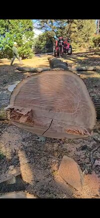

Here's the stick of another one. Fairly straight oak... not much chance of failure. Fairly big center plunge leaving 2 small posts. Cut the first up real small leaving only an inch or two of thickness.
Then bring the saw around the other side until (with the given pretension) the back cut starts to open just a hair. That way i know she's cut up and cue the pull.

This stump is 5 feet across the long way. Those fat posts are 6 inches plus wide. Pulling with 2 ropes on the loader. I took a running start at it with the loader. By the time the hinge posts let go, the momentum was 100 percent taking this tree to the lay. You don't get momentum from banging wedges.
Another significant advantage to the pull line and loader is that you don't have to stay at the stump during the fall. That's another clear difference between GTW and logging.
