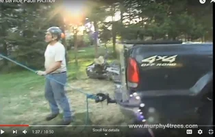

. Thoughts on the notch at 640. Interesting video that pertains to this discussion. @August Hunicke @rico @Daniel
Its just a big wide open undercut, where the 2 cuts don't bisect (Block cut). Like everything August does, it was done for a reason, and worked perfectly!
