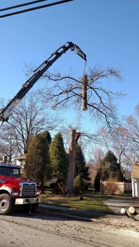

No that was a 60t rental. I worked with the other crew today as my crew is down to me and one other guy. The owner went hunting. We had 5 ground guys who knew what to do. They did well with the pics. My back was killing me and I was hurting so the plan was to take them as big as we could and get me on the ground as fast as possible. 6 pics. 4 in the canopy and 2 trunk plucks. As long as I wasn't moving I wasn't in pain so I welcomed the processing time.
Awesome job Steve and I am glad to see you and others using "multi-point slings" as necessary for crane work.

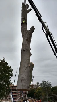

If you don't have gunnebo crane hooks you are missing out. On our brush picks we normally use one round sling w/gunnebo hook as the main load bearing sling and two spliced Tenex slings in 20' lengths. We normally use more than one sling because it always comes off prettier, safer for the climber, and less shock for the crane.
