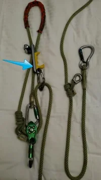

Kong hand ascender and Revolver always goes with me. 3:1 can easily be 5:1pick off or to help climbers attached to a zip line , or 6:1 climbing. This works just as well on the tail of my SRT climbing line that had a DdRT system on the tail.
The hand ascender also gives me extra grip if the rope is wet, or long ascent or protection from sliding dead wood or wild tosses with a throw weight above a big top multiscender.
