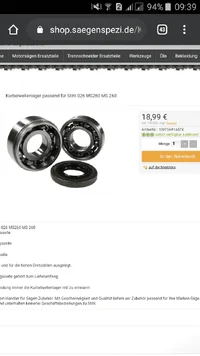

I have source for aftermarket bearings, but it's probably better to just go with oem.
