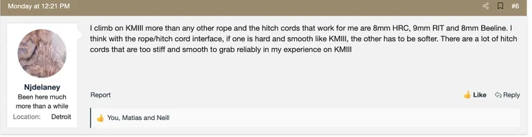

This is more what I was getting at. When I tried the KMIII the distel I usually use, was slippery. 8mm cord grabbed better than my 10mm. I’ve mostly figured out how to keep my RW from seizing when weighted on my 24 strand Samson ropes. I’ve seen a few posts about static ropes are for mechanicals only…but, that’s probably someone’s opinion. I just wanted a static/kernmantle to help with SRS and hitch cord. I’m on the fence if/when I try mechanicals.
There is wisdom in Noah's post #6. Hard greasy/slippery ropes and hitch cordage with similar properties is a recipe for failure. I am a light climber and have had great success with 8mm HRC and 8mm beeline on kernmantle.
