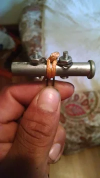

I like the homemade? wire fid. Looks to me like this would work really well in place of the vice grips that I use to pull a wire fid thru 16-strand.

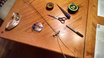

That is actually the ABR/RopeLogic wore Fid they sell. Works fine for 16 strand but. I have to go in twice for the bury, i had a 3' one that I could do the bury in one go at it. I've never tried a toss wand as wire Fids have worked fine for me. That picture is all stuff I got from Fids and Fibers or was suggested by mark p.

I just checked and see that the ABR wire fid is only $12.95 at Treestuff. Sounds like an excellent buy to me! It also looks like it would be easy to modify the fid to make the wire longer?
image.webp Some homemade splicing tools. The brazed eye wire and the wooden fids are the earliest. The long screwdriver was turned into a wand with some Dremel work.

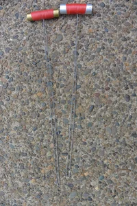

Just be forewarned. Splicing is an addiction! Also, for anybody thinking about splicing 16-strand, I highly recommend that you watch Nice Guy Dave's video on youtube. He pretty much nails it. The main thing I would suggest that you do differently relative to his video is to use a wire fid with a handle as opposed to pulling on a wire fid with vice grips. Once you learn how to splice with wire fids you will rarely ever go back to splicing with tubular fids or push rods. You can buy wire fids with handles from Mark at "Fids and Fibers", or you can make your own. I am pretty sure there are examples of these illustrated in some of the old posts in this forum. Here are a couple of mine. The link to Nice Guy Dave's 16-strand video is also attached:
