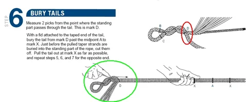

I took a look at these directions and I'm wondering if step #6 is illustrated correctly??? From the instruction's text, I believe the tapered end is supposed to enter at mark D. I don't think that's what is illustrated.
Is it just me?

As I look at it, I think it's written correctly. Remember they are using a fid and a pusher, not a pulling fid (coat hanger) so they are pushing the rope in at D then out at the furthest X mark. The tails cross between the X's.

YOU'RE RIGHT! I looked at it again, more carefully. The description is right, and what they show at the bottom is right. But the more zoomed in drawing that I circled in RED does show an EXTRA pass through the rope. I think Samson intended for use to just do a locking brummell, then bury it. It wouldn't make sense to pass through again. I'll call and find out for sure.
See the pic to see the parts I'm talking about. Is this what you were talking about, tom?

That's it exactly. From what little I know, it just didn't look right. Thanks for clearing that up Nick!
