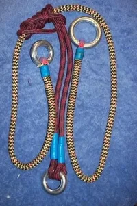

Thanks Nick. I agree totally now about the bury for a shorter eye n eye. I used it for this application. (multiple pic posts sorry) and will now try it as a fl prussik.

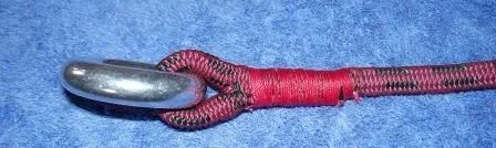

This is an eye n eye I have used to tend my micro pulley on a work positioning lanyard. It is a locking brummel. I have since deceided to use either the original cover or leftover velocity in the eye instead of shrink wrap. Please go into more detail about running the cover up, or taking the cover off and putting it back on. Are you saying take the cover completely off, splicing, and pulling it back on or putting the cover (a piece of it) on the eye during the splice? Pics pls.
Is that blue and purple stuff just shrink wrap, or is it that special tape stuff that bonds to itself (not just an adhesive coating?).
If you taper the last 1/4" or so of the cover tail before you whip & shrink-wrap it, you'll end up with a smoother splice that is less prone to chafe.

If you're doing the whip & heat-shrink tube, I'd just cut the last 1/2 of the cover tail at a 45* angle, just so avoid that visible bump in the shrink-tube. Mostly aestetic, but in the long run (if that comes in to play- which it usually doesn't when it comes to arborist ropes!) chafing could be an issue at the bump, so minimizing the bump also minimizes chafing, too.
