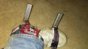

It has been way harder to effectively create a step on the bottom of my boot for my left foot than I thought it would be. I am on my way to see what sort of cinching straps I can come up with to keep it on there.

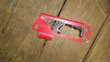

I did find a hand ascender that has a cam that locks open and then releases with one action. It came from a marbar that was in the toolbox on the truck when I started this job like 4 years ago. It appears to have a CMI sort of vibe to it, but there is no branding on it. I opened up the rope channel and shaved a thumb grip from the lock lever and now it is the fastest way that I can imagine to set a weight on a line.
Not as old as my Jammar, lol. Didn't realise newer hand ascenders don't have a nice 'quick release'. Will watch for this.
The stuff I'm used to has a pivoting lock lever on the bottom of the cam so that it is a down/out motion followed by a sweep towards the line. Much slower.
I think I've got it. I'll wrap the ends in an old radiator hose and tape up the step.

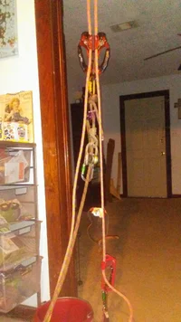

I'm about to go practice jumping on a line and see if I can honestly get under 10 seconds.

About 50 practice setups and I'm averaging about 7 seconds if I don't bumble one of the four cams. I bought a new rope today which helped. It's rather stiff. Samson Mercury.

You'll have to post a pic of your setup!!

I've got everything out. I'll snap one.
I've reverted to my two hands, one foot ascent. My time will hopefully be a little better than last time (18 seconds) with all 8 setup, changeover, backup points.
