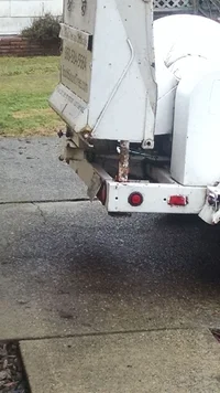

My leg is super simple. One piece of pipe with a slightly smaller piece inside. One pin and cotter key, with many adjustment holes. The pin jams under the frame if it tips back a bit. No need for pressure, though the tongue jack can easily counter-pressure against the leg/foot. I disconnect sometimes for minimal feed tray height, maximum discharge height/ distance to chip pile or woods.
Nothing fancy, easily shop-made, possibly from scrap.
This is a picture of it stowed, with the pin and cotter key on top of the frame.
