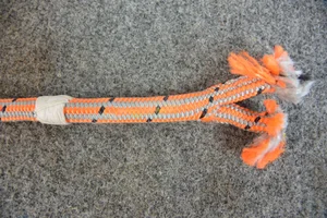

How many strands, and if you pull some of the core out, can you easily milk the cover back over it? If the strands won’t go back in, it might be a dynamic, or semi dynamic line, maybe for European requirements.
I'm not sure Brock.. I've always been under the impression that the sirius lable meant it was a 32 strand... But to be honest i get awwwwlllllllll fucked up trying to dechiper the common language/spec with what teufelberger or other companies actually posts.. I think there's some common disconnect there where I'll count 32 individual stands on something yet it's labled as a 16 strand or plait. I never know when or why they are counting individual countable strands or if there just counting the bunch of 4 or 2 as 1. I've been trying to get to the bottom of that one for a while.. also Plait vs Strand.. for some reason i believe there is some common difference, just unknown to me & probably basic 101 i was never taught.. Lol.. Chyeah, "taught".. more like "never found in researching." I think if i knew what the actual weaving patterns were called, how they are used & for what purposes, I'd have a better understanding. I feel like that's the missing link in my mind.
When i first got it, in order to confirm the mystery, i milked it back some.. all came out & went back in as normal.. i didn't go more than a few inches though as i didn't want to disrupt what i was about to sew.. I've never handled a true dynamic cordage so i couldn't tell you if familiar.. It definatley gets taught when loaded, which to me, highlighted the reasoning behind them using this variation as a lanyard.. here's an up close i took earlier to post over on the hand sewn thread.

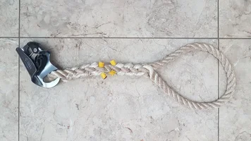

Picked up a petzl basic on tree bay and wanted to make up a knee ascender. Forgot to order some hollow braid with my last order so was forced to use what I had....I'm glad I didView attachment 57856
