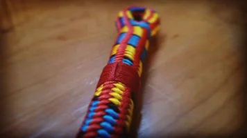

New removal lanyard I made this weekend. I took a pick of my "stopper knot" I make on all my lanyards since it's so much smaller than a knot and serves the same purpose, stop my hitch.
I just pull a smidgen of the rope out, cut it, fold the cover back, whip it, then nay nay.
Another tid bit so freely given by Oceans/ Eric w. Call it Ocean effect
Add long as you finished the whip wit a nay nay then you should be OK

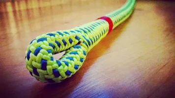

For now, here is the first splice I have ever done:
Well I tried anyways . . . I couldn't quite drive it home all the way. Since I've done this one I learned a few things: Tachyon is really hard to splice even if its not your first splice, and that I can take a mallet and hammer out the throat and then pull some more. So I will try that when I have some more time to work on it.

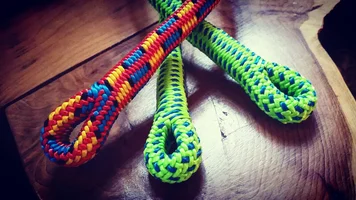

After I tried the tachyon I decided I should find something more my speed and played around with some tenex tec. Heres a whoopie and a couple of loopies.
IMG_20160702_164747.webp IMG_20160702_164757.webp IMG_20160702_164845.webp IMG_20160702_164806.webp IMG_20160702_164942.webp
Do the areas showing where the rope isn't dyed matter? IMG_20160702_165005.webp
The un-dyed areas are normal, as long as they're due to entrance or exits and not a pick or pull that unbalances the strands. That photo looks normal.
The 3 strand inner core of Tachyon does add some steps that don't exist in other DB lines, but I think a few things that will make ALL double braid splices easier are:
- solid grasp on the mechanics and visualization of the final product on the inside and out. (this understanding aids the entire process)
- quality taper.
- tight crossover. Toight like a toigah, and don't loose that tension during the bury.
From the photo, the Tachyon eye looks like it may have cover slack in it. Cover can result from a loose crossover, and leave the fibers of the eye unbalanced. This can make the bury tough, since the core gets tight before the cover reaches the eye size marks.
Keep at it. You got this!
