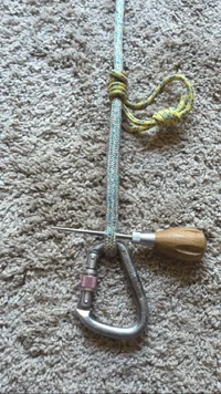

Thanks for the feed back everyone. I gotta say I really appreciate the help with getting started into splicing. Well I went for my second and third double braid splice. This time with some velocity.
Here is number 2:
View attachment 38695 View attachment 38696
I'm pretty happy with the way this one turned out. That is unless you guys tell me I shouldn't be. I tried to keep it "toight like a toigah" at the crossover and it took lots of popping to get it to finally go home. Here is my setup: I have my slip knot hooked onto a carabiner on an eye lag bolt sunk in to a wall stud. Once I get the eye in as much as I can by hand and carabiner I run a bar through the carabiner and pop it away from the slip knot about as hard as I can. It seems to me that it takes a ton of force to get these to go home.
I also had to google up toight like a toigah. I found some disturbing images and was about to give it up til I remembered austin powers . . . . I have so much to learn about arboriculture.
Here is number 3:
View attachment 38699 View attachment 38698 View attachment 38700 View attachment 38701 View attachment 38697
for this one I tried to bury a longer piece of the core - over a half fid past instead of 1/3. The throat is rock hard and I could not run it all the way home. After the fact I tried rubbing it down with some dish soap and hammering it out some more, but its either not moving or moving in increments too small to notice. Is there any hope for this one? Recommendations?
There's something about splicing. . . i can see this becoming an addiction.
Try inserting your awl through the cover and core on the "standing" side of the eye, just above (eye side) of the throat and pulling against your anchor. Also, use a small diameter Prusick cord to pull more cover slack. These two should do it. Also, keep a biner in the eye, so you don't close it entirely.
