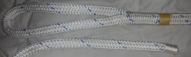

Made up a 16' x 3/4" stable braid eye sling last night with a 12" eye. Whipped the end too. What you boys think?

Nice and neat, I'm a dyneema 12strand fan, I like it for lightness and strength.

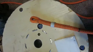

This is my 3rd attempt and first completed with tachyon. I apologize for the marker, I didn't have safety pins at the time.

That sure looks nice to me. Looks like you made it without any loose cover slack in the eye. The tuck from the throat to the whipping seems pretty consistent, and the taper seems smooth. I bet it was a tough pull, but it looks like you did a nice job.

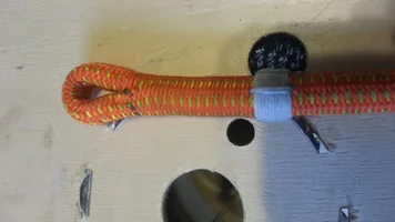

Pic 2. Anything look good or bad? Very new to splicing so any ideas should help. Thanks.

Good splicing, have a think about lock stitching instead of whipping, so you can hide the thread, so it looks super smooth and will not add any hindrance.
Tuttle, please tell me how to lockstitch where it's not visible....or at least give me something i can google. i've asked once on another thread already to no avail.
